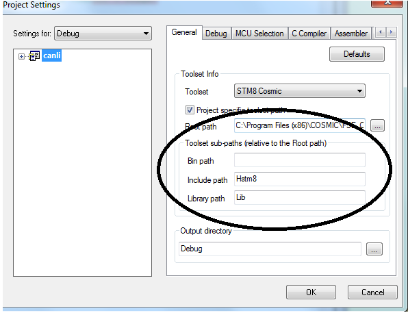

i add
crts.s file manually and all compile ok.
But Should i had to add
crts.s to my project?.
Why Setting like below is not add crts.s to in my project automatically?
Posted on April 11, 2017 at 12:24
When i run the software, software has problem such as RAM, stack and etc.
Should i add
crts.s file to in my project manually or not?
Posted on April 11, 2017 at 17:40
use crtsi instead of crts, it also does variables initialization in the data section and that might be the problem you see.
You surely need to have one 'crts' (C Run Time Startup) file in your application (usually crtsi) to perform all the initializations needed by the C langiage environment: you can add it manually to your projet or use the precompiled version and just link it, depending on your preferences and on the way used by default by your IDE.
