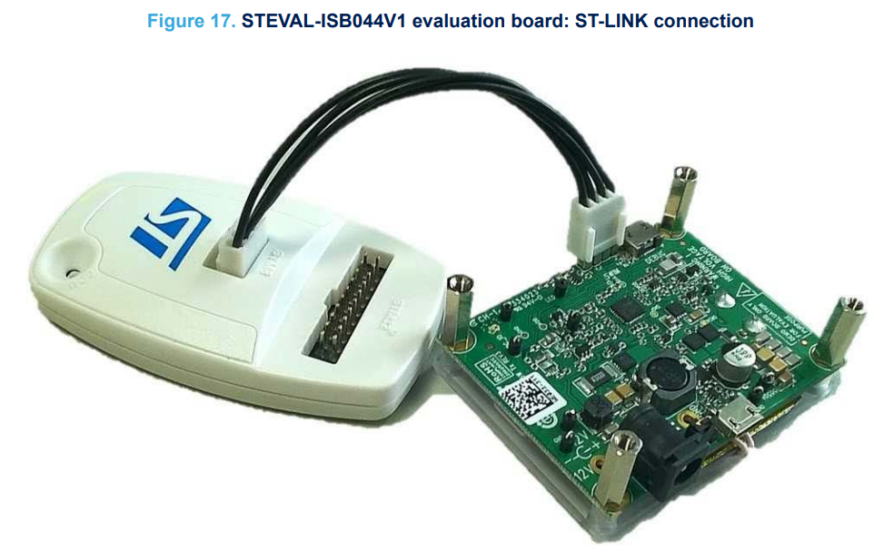

Thanks for your reply. But I do not quite understand what does the sentence "the connecter is not keyed" mean. On the user manual of the board, the connection looks like this:0690X000009k8BAQAY.png

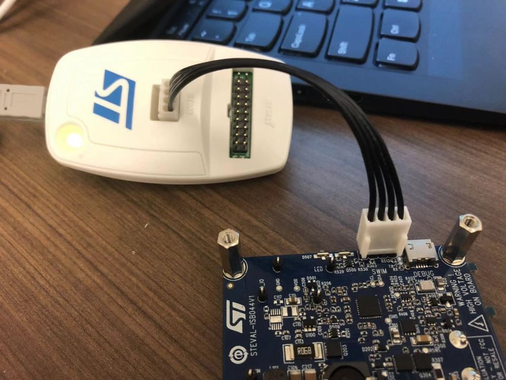

and here's my connection:0690X000009k8BtQAI.jpgAlthough there's a communicate error, the light on the ST-LINK V2 is green. If I change the connection way, it will turn to orange or red.
Would you please tell me the correct way to connect the ST-LINK V2? Thanks.

The connection on the picture looks ok, so its probably some other issue.
Have you tried with alternative software (e.g. if you are using STVD, you might try stm8flash), so we can rule out a problem with your software installation?
Have you tried using a different ST-Link (e.g. one of those cheap Chinese clones), so we can rule out a problem with your ST-Link?
