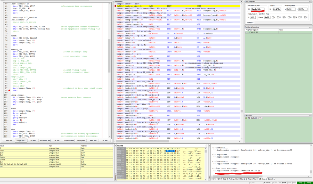

IRET returns to nowhere from wakeup timer ISR as soon as programmable alarm interrupt is active!
Here is the STVD screen where programmable alarm and wakeup timer interrupts are enabled and wakeup timer ISR is just about to end. In the memory window at the bottom centered you can see a nonsense address stored in stack (highlighted with yellow).

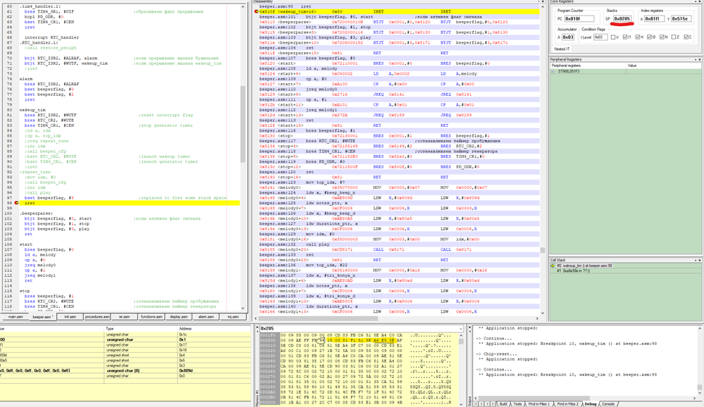

_legacyfs_online_stmicro_images_0693W00000bjJREQA2.pngNext is the screen of the result of IRET instruction

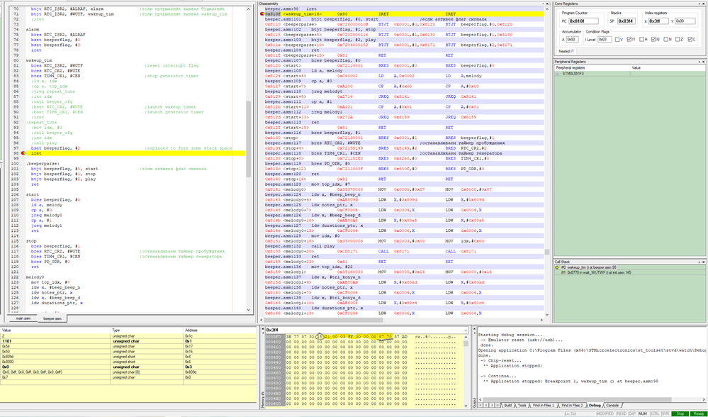

_legacyfs_online_stmicro_images_0693W00000bjJRiQAM.pngAnd a screen with programmable alarm disabled where MCU exits correctly from the ISR

You have a problem with stack and this is not related with alarm and wakeup timer being both enable.
Do you use large buffers of local variables?
And it seems that you develop code in assembly, not in C.
How the program reaches ISR routine?
Show the ISR code and vector table.

You were right! The problem was the stack overflow. I used to call a procedure from ISR and seems like next IRQ fired before previous ISR over, so stack was overflowed.
Thanks a lot for giving a hint!
RDien
Alright, the real reason after all was an extra IRET which made stack pointer wrap around and counting down from the top.
