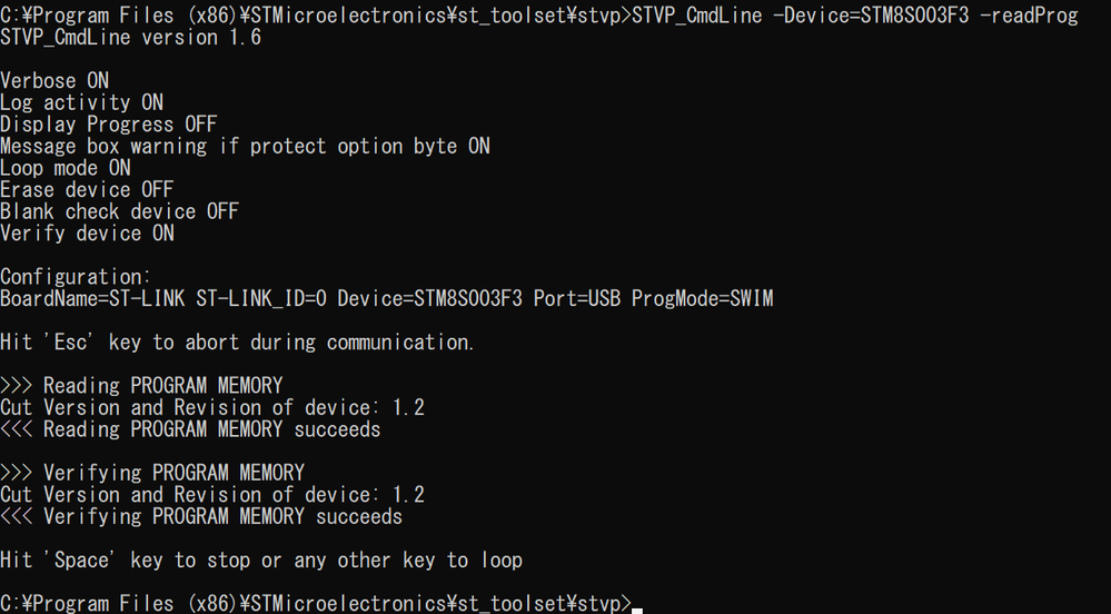

2021-05-24 7:59 PM
Hello Simon,
Thank you, I can now write to a specific area of PROGRAM MEMORY.
Moreover I want to read this via SWIM. I tried using STVP_CmdLine.exe, but I don't know how to get the value of a specific area. Isn't it the -readProg command?
Regards,
Gotoda
2021-05-25 12:01 AM
I agree with your remark.
STVP command line tool is dedicated to device programming automation.
You should use the windows visual version of STVP to read specifically a desired memory area.
Regards,
Simon
2021-05-25 11:39 PM
I understand that it is difficult to automatically read the values of PROGRAM/DATA MEMORY on the production line.
Thank you.
