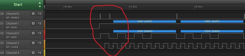

There is a problem with the transfer on SPI how to track that this left?! Here is the function code for the transfer of bytes via SPI and a picture with a logic analyzer, circled in red, what confuses me is that for a glitch!
