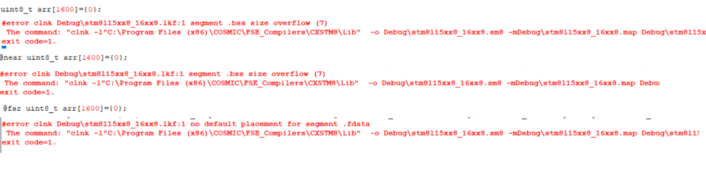

I want to expand array size until 3000. (i.e. arr[3000]). I have 4KB RAM.
currently I can get value till arr[1500].
I tried different options to expand size but no success. Please see below image.
How to expand array size?

Other variables and stack take up space, too. Review the map file.
Manage to get along with smaller array sizes, or get a MCU with more RAM.
