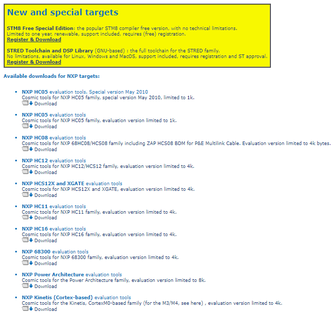

https://www.cosmicsoftware.com/download_stm8_free.php
TVela.1
Hi Tesla DeLorean,
Thank you for your comments, could you please point me what is the cosmic version for "stm8a-discovery"?

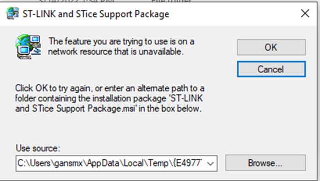

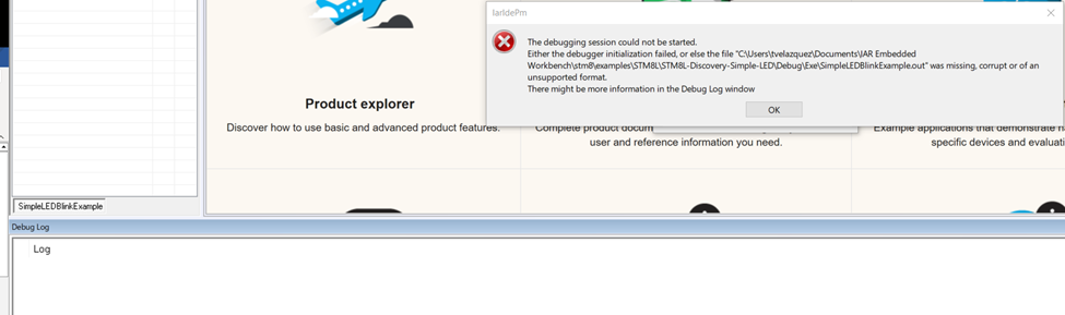

_legacyfs_online_stmicro_images_0693W00000bijDfQAI.pngAlso, I'm trying with IAR workbench stm8 but i had this issue with the ST-link (when is compile a example project (SimpleLEDBlinkExample)). What do you think it is due to? I tried to solve it but no success.
Thank you in advance.

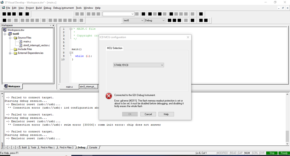

Thank you for your proposal but it's a existing product. I must turn on a led with a button for a electrical test but I'm having too much issues to find a software and tools.

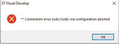

Hi Tesla DeLorean,
Do you know what is my issue? and how can I solve it?

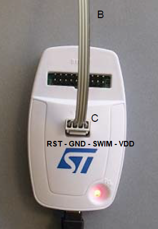

_legacyfs_online_stmicro_images_0693W00000biuY0QAI.pngI'm using the ST-link v2 with the STM8 part as you can see below.

stm8a-discovery have an embedded ST-LINK. So you don't need an external ST-LINK. See UM1574.

Sorry, I forgot to mention, but now I am using the STM8L151C8 MCU, I solved the issue with stm8a-discovery.
