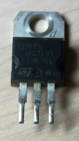

Hello. Help identify the item.

Can you post something in higher resolution? or transcribe the letter/numbers as you read them.

STP110N7F6
