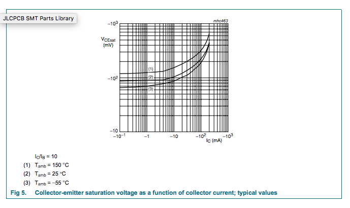

Actually the tough thing is they always seem to give the Vce(sat) with a gain of 10. Looking at the PMBT3906 from NXP for example (https://assets.nexperia.com/documents/data-sheet/PMBT3906.pdf) :
How will those values change with the Ic/Ib ratio?
In my case with 10k base resistors I get about 0.25mA base current, and with 2 segments on I get about 12 mA collector current, and with all the segments on about 50mA collector current - so I guess I have a ratio moving between 50 and 200.
