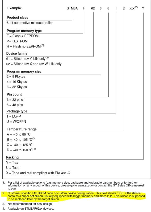

Can the device STM8AF6226TCY be replaced by the STM8AF6226TCSSSY? Are they the same product? My customer wanted STM8AF6226TCY, but what we found was STM8AF6226TCSSSY.0693W00000QNmAeQAL.jpg
1 REPLY 1
hhe.1
Both materials are the same​
