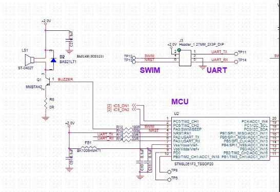

What is behind your definitions: LED_R_GPIO_PORT, LED_R_GPIO_PINS,LED_G_GPIO_PORT, LED_G_GPIO_PINS.
Are you using internal default clock or some external crystal.
May I ask you for a part of the schematics with visible power pins, NRST, SWIM connector, please?

Posted on June 27, 2018 at 03:03
Hello, Artur, ,
Thankful for your concern, ,
I update the schematic, and more description for your questions, please refer it and give me your guide,
♯ define LED_R_GPIO_PORT GPIOC
♯ define LED_R_GPIO_PINS GPIO_Pin_0
♯ define LED_B_GPIO_PORT GPIOC
♯ define LED_B_GPIO_PINS GPIO_Pin_1
I am using internal clock and tried to change from 2 Mhz to 16 Mhz...with the following code,
But I can't see LED light in all case, the output voltage of LEDs is zero....

Artur IWANICKI
Posted on June 27, 2018 at 12:10
The problem is related to the fact that PC0 and PC1 are true open drain (no internal pull-up nor high side transistor in output configuration). To make it working you need to add external resistors.
Please have a look at datasheet into pins specification for more information.

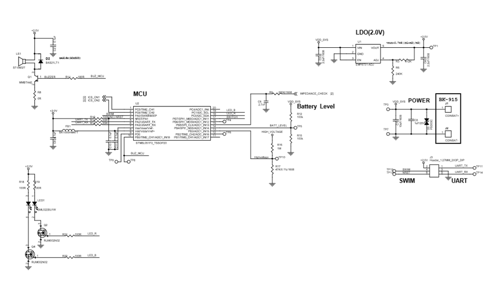

Posted on June 29, 2018 at 14:03
Hi, Dhenry,
I found something to solve issues,
firstly, the gpio pins related with LED is wrongly selected, we changed it,
secondly, we found another solution to use beep function with the same port as SWIM....
thirdly, as to priority setting of timer, I can't find the method to set up the priority,
but when trying to do something that I hope to do in interrupt service routine function directly,
I can control the gpio normally,....so the issue is solved,
but currently, I can't normally download image with STVP, we don't know the reason,
Could you please kindly help us to know the reason ?
We worry whether our circuit is problem or not,....need your help to review it,
