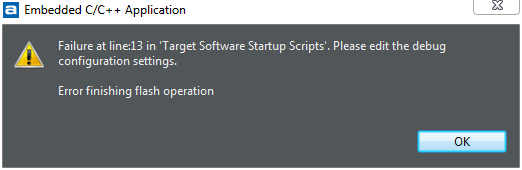

I have a project created in Atollic TrueStudio V9.3.0 which was until recently working without problem. Now when I try and debug the project on my target, the cube programmer crashes at the 'load' stage of the startup script.
I get the following error dialog.
0690X000009k1v6QAA.bmpWhen I close that dialog I get the following
This error also occurs when using the new CubeIDE (which also uses the CubeProgrammer to download).
