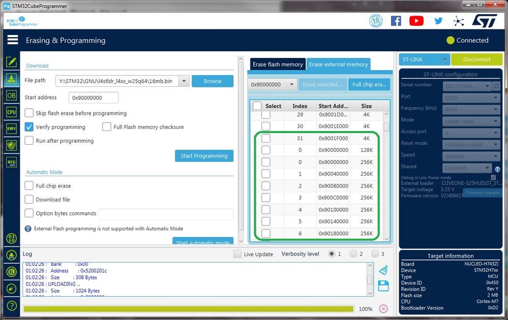

I have an external loader that needs to describe
32 x 4K Erase Blocks
1 x 128KB Erase Block @ 0x90020000
511 x 256KB Erase Blocks @ 0x90040000
The decoding of the base address resets to 0x90000000 for some inexplicable reason

2023-03-22 6:36 AM
Ok, when check boxing the 128KB sector, the one that lives at 0x90020000, the tools pass the loader an EraseSector(0x90000000), so the address computation code is some how broken.

2023-03-30 6:46 AM
It's an enumerated list of counts and sizes, should be apparent from table in binary
See also trailing comment here
STM32CubeProgrammer_v2.10\bin\ExternalLoader\IS61WV51216BLL_STM3210E-EVAL\Sources\Loader_Files\Dev_Inf.c
Related defines for attached file
#ifdef USE_S25HL01GT // 128MB
#define PART_NAME "S25HL01GT"
#define QSPI_FLASH_SIZE (128 * 1024 * 1024)
#define QSPI_FLASH_SHIFT 27
#define END_BLOCK 0x07FC0000 // 128MB-256KB-1
#define USE_SPANSION
#define USE_ADR32
//#define ERASE_BLOCK_SIZE (256 * 1024)
#define ERASE_BLOCK_SIZE (4 * 1024)
#define COMPLEX1_BLOCK_SIZE (4 * 1024)
#define COMPLEX1_BLOCK_COUNT 32
#define COMPLEX2_BLOCK_SIZE (128 * 1024)
#define COMPLEX2_BLOCK_COUNT 1
#define COMPLEX3_BLOCK_SIZE (256 * 1024)
#define COMPLEX3_BLOCK_COUNT 511
#endif
2023-04-18 3:14 AM
Hello @Community member ,
First I apologize for the late reply,
The issue is confirmed and it is raised to the development team to fix it. I will keep you posted with updates.

2023-07-11 12:52 AM
Hello @Tesla DeLorean ,
This issue is fixed in STM32CubeProgrammer latest release.
V2.14.0 is now available under this Link.
