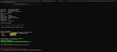

I'm encountering an issue while using an external loader to program an external flash memory (MX25L6433F) on an STM32H563IGK6 board. My objective is to access this external flash (OCTOSPI1) with DFU for operations like erasing, writing, and reading, specifically to download my application into the external flash.
However, when I run the command using STM32CubeProgrammer via the command line, the program loads a bootloader named "STM32H7RS-DK" instead of using my custom bootloader, which is already running on the board.
I have a few questions regarding this behavior:
Why does STM32CubeProgrammer choose to load this "STM32H7RS-DK" bootloader? I understand it is a secure bootloader, but I'm unclear on why it's being selected.
Does this mean my custom bootloader will be ignored or replaced?
What exactly does this choice of bootloader by the program mean, and how can I access my external flash (erase, write, read) while still using my own bootloader?
I've attached a screenshot for more details on the messages displayed.
Thanks in advance for your help!

Hello @Tesla DeLorean , @Gnour ,
>>Why did STM32CubeProgrammer choose this bootloader for the download, and what exactly is it? What is its relationship with the external loader?
It is a bug and it probably happened due to the fact that programming external memories via bootloader interfaces is only supported in SFIx or for H7R/S via OpenBootloader external loaders (The ones ending with OBL in the list of external loaders in CubeProgrammer).
So to conclude :
1- The error message should change and "OpenBootloader_STM32H7RS-NUCLEO.bin" should not be loaded. Request tracked in Ticket 188770.
2- Some clarifications requested in the user manual tracked in Ticket 188772 to mainly state the current limitations for the -elbl option.
@Gnour , for H5, this feature is not yet supported in STM32CubeProgrammer.

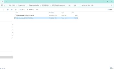

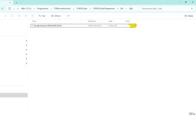

I also wanted to let you know that I replaced the
OpenBootloader_STM32H7RS-DK.bin
file with the binary of my custom bootloader, keeping the same name (
), and it was successfully downloaded. However, I'm still not clear on whether external loaders for the STM32H7RS-DK are secured with SFI. Does that mean access to the external loader requires a secure boot, and it’s not available yet?

‎2024-08-15 6:01 AM - edited ‎2024-08-15 6:02 AM
Thank you for the explanation @Aziz BRIGUI . Unfortunately, I wasn't able to communicate with the external flash .I couldn't perform an erase or read operation. However, the binary of my custom bootloader was successfully downloaded, though I'm not sure where exactly it was stored. It's important to note that the custom board is already running my custom bootloader, which is why it was detected in DFU mode.
I’ve also included screenshots showing the modifications I made.
