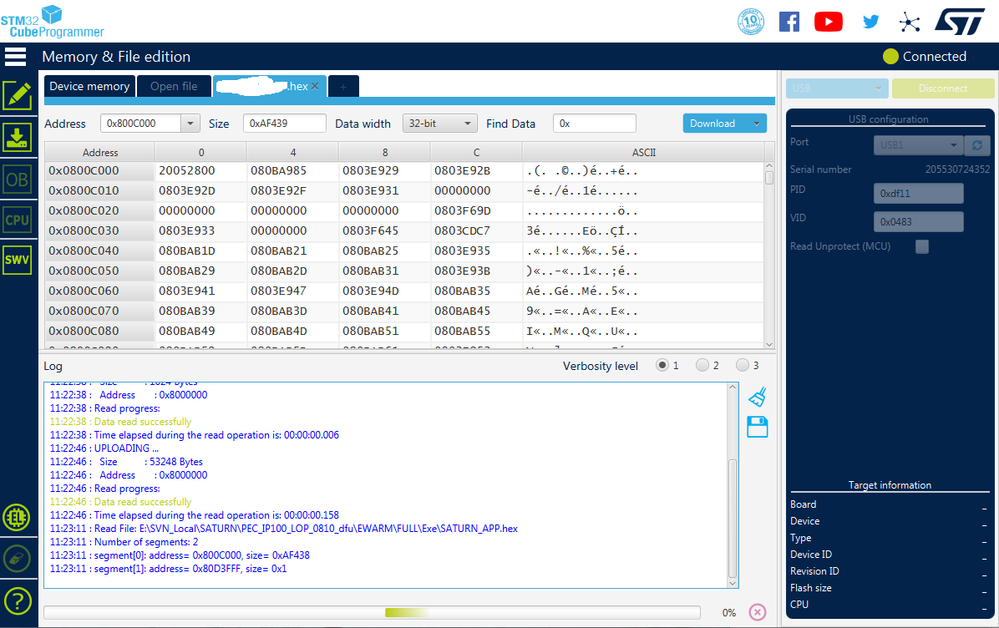

i tried to device memory read in cubeprogrammer, it worked.
i checked this in iar workbench that function MEM_If_Read_FS called
but, when i tried fw download using cubeprogrammer, only the progress bar moved from side to side, the cubeprogrammer did nothing. also, MEM_If_Erase_FS, MEM_If_Write_FS not called.
0693W00000D2ES5QAN.png -> it's stuck in this state.
I want to debug, but I don't know where to look because two functions don't worked.
Why did this problem happen??

JPark.20
Interrupt priority was set higher usb than systick. So, the tick did not increase, and remained in the hal_delay function. I was thinking that the function was not called. I hope no one makes the same mistake as me!
