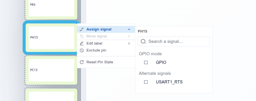

Here I must defend CubeMX2, though.
Right click and you get this pop-up;
And can select GPIO with a second click. Edit Label is an extra "hover" (click not needed). I can live with that.
You can select "GPIO", yes, but you still need to configure it as output, hence the additional 4 clicks.
