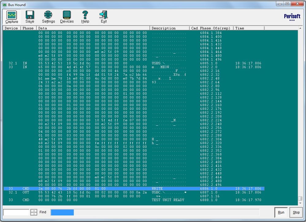

STM32CubeMX+STM32L476RET6+MSC+SD. Windows 7 Can Read/Write file,but can not format.Anyone can help me?

I don't know, right? The test Windows 7 is readable, written and formatted.
In usbd_msc_scsi.c file SCSI_Write10() function
Before:
/* check if LBA address is in the right range */
if(SCSI_CheckAddressRange(pdev, lun, hmsc->scsi_blk_addr,
hmsc->scsi_blk_len) < 0)
return -1; /* error */
Modified:
if(SCSI_CheckAddressRange(pdev, lun, hmsc->scsi_blk_addr-1,
