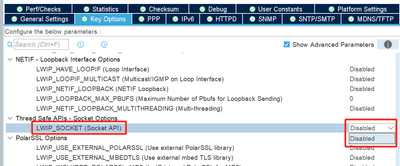

I have a Nucleo-F767ZI board, and am trying to configure it to use its LEDs, USART3 which is the virtual com port of the ST-Link on the board, and eth, I added LWIP, but I am unable to enable the LWIP_SOCKET as it requres to enable LWIP_NETCONN, by looking through the "General Settings" and "Key Options" with "Show Advanced Parameters" checkbox checked, I did not get a clue on how to do it.

To be able to enable the LWIP_SOCKET API, you should enable an operating system (FREERTOS for example).
