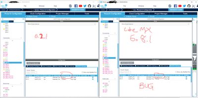

Auto-conversion from a CubeMX 6.2.1 File to a CubeMX 6.8.1 compatible file through CubeMX 6.8.1 does NOT retain the UART4 GPIO Pull-up/Pull-down settings from the original file. Thought I'd share it here in case someone else is running into this problem as well.

Hello @df
In CubeMX 6.2.1 , the default value of GPIO Pull up/Pull down was Pull up, this default value was changed to No pull up and no pull down in CubeMX 6.4.0
Thx
Ghofrane
