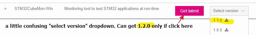

you are right, I thought 1.2.0 is released recently, but it was already available around April 2021. Probably @Community member downloaded older version because of interface
As seen on this image, select version does not include latest version download link.
2021-09-20 2:08 PM
Thanks. I had fallen into the trap of selecting V1.1.0 from the drop down. I had wondered where you got V1.2.0 from! I should have opened my eyes...
After updating the setup tab is visible and the warning message is gone. Note that even though there was a warning message it was still working correctly and was super helpful in debugging.
Thanks for taking the time to share your idea and help me.

@Community member and @Georgy Moshkin , interface have been updated and now shows the latest version in the Select version list.
Thanks' for your feedback.
