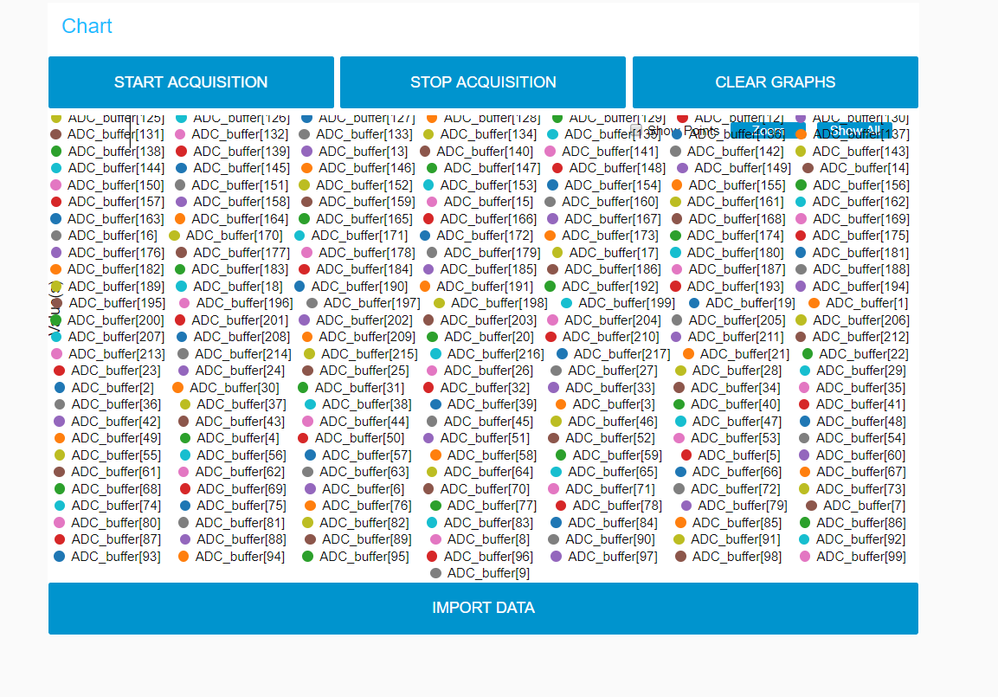

How to watch an array using STM32CubeMonitor?
How should I configure STM32CubeMonitor to watch the flow of an array? I can either select the first position or expand the array but then the graph will be a mess. See below.

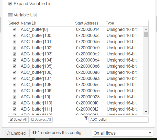

  18. Press "Expand Variable List" → write first array name in lower-right "filter" field and press "Select All" button
  19. Select all elements of second and third array using same approach: write name in filter → press "Select All"
  20. Write some text in "Name" field, this will enable "Add" button
  21. After pressing "Add" button large arrays cause significant delay before STM32CubeMonitor user interface become responsive

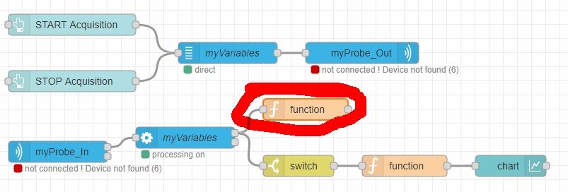

  1. Top right corner menu button → Import → Library → Stm32CubeMonitor_BasicFlow.json
  2. Deleted previous unused tab "Basic_Flow"
  3. Top right corner menu button → Import → Clipboard → "select a file to import" → sigview2.json
  4. "Some of nodes you are importing already exist in your workspace" → Import copy
  5. Delete "Mychart" and "Clear Graphs" nodes by selecting them using mouse right-click and pressing "Del" on keyboard
  6. Connect "myVariables" node output to newly imported "function" and "switch" nodes as shown on screenshot/in video
  7. Select ST-link in "myProbe_Out" and "myProbe_In" nodes
  8. In upper "myVariables" node press "Add new exe-config..." → select path to *.ELF in your project directory
  9. Set checkbox "expand Variable List" to expand array elements to separate variables
  10. In filter textfield write "testBuffer" (case sensitive)
  11. Press "Select All" button to select all elements of testBuffer[0],testBuffer[1],testBuffer[2],... array
  12. Put some name for executable in "Name" textfield, so "Add" button will become available, press "Add" button

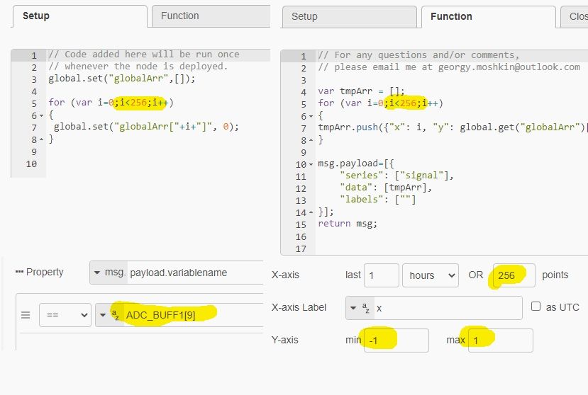

Update 2021: watching array with different name/size
Assume we have an array ADC_BUFF1 with values ranging from -1 to +1
float32_t ADC_BUFF1[256];
for (int i=0; i<256; i++)
	ADC_BUFF1[i]=sin(2.0*M_PI/256*i);
To make it work
  1. double-click first function
  2. open setup tab
  3. replace 1024 with 256 in for (var i=0;i<256;i++)
  4. double-click "switch"
  5. replace text with ADC_BUFF1[9]
  6. double-click "chart"
  7. replace 1024 with 256, set Y-axis min/max to -1 1
I see that Setup and Close tabs are missing on your screenshot, I do not know why. Those tabs are common for function nodes in Node-RED, for example:
https://discourse.nodered.org/t/setup-in-a-function-node/39445
What happens if you put empty function node and double-click on it? Still no Setup/Close tabs?

Hello
The graph has not been designed to display arrays with so many entries. I guess you don't want to have one hundred of curves in one chart.
There should be some better options with node-RED.
  • How many data do you have in the array ?
  • How do you want to display it ? All values should make one curve in a chart or in a table ?
  • Does the values evolves in real time ?
Best regards
Stephane
xpp07
xpp07Author
Dec 11, 2020 12:05 PM UTC
Thanks for your response. The array is 220 elements. I would like to have both options, either see them as one curve or in a table. The values do evolve in real time.
stephane.legargeant
Dec 14, 2020 1:46 PM UTC
Hello
STM32CubeMonitor was not designed to handle array of data. Data are managed as individual elements, and there is no way to group it. The first issue is to select all the symbol, and then the display is not adapted.
There are some workarounds to display the data :
1) Export the data in a file, and convert it to csv file. Then use excel or other tool to analyze it. (see other posts on this topics for details)
2) Reorganize the data to send it to a bar chart. Node-RED chart is able to display a bar chart from data not based on time. Then the array value can be displayed.
Best regards

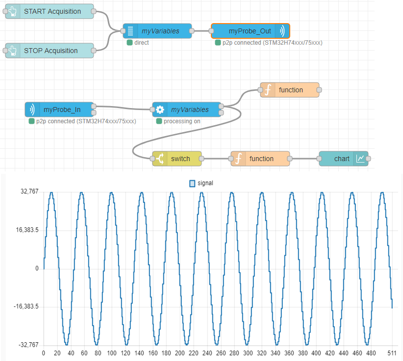

Here is working example of watching 1D array in STM32CubeMonitor: sigview.zip
after downloading,
1) import sigview2.json file to your flow, add two connections as showed on !view-me!.png image. Fix all the errors, delete unused stuff.
2) Add test array to your buffer as in main.c, build
3) Add array elements to your STM32CubeMonitor configuration with "Expand Variable List" checkbox checked, filter variable name by entering "testBuffer" and press "Select All" button under the list.
Signal array is filled on MCU using:
for(int i=0;i<512;i++) {
 testBuffer[i]=(int16_t)roundf(32767*sinf(2.0*M_PI*1000/44100*i));
In STM32CubeMonitor/Node-RED:

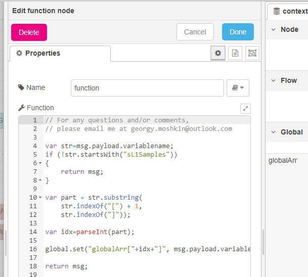

function 1:
setup tab: creating global variable globalArr
function tab: parsing msg.payload.variablename to get array element index, putting array element to global array
this function gathers single array elements from probe to one global array
global.set("globalArr["+idx+"]", msg.payload.variabledata[0].y);
switch:
works only when variable name is "testBuffer[9]" (not testBuffer[511] because of alphabetical order)
function 2:
creates msg.payload for chart only when switch is triggered, so chart is updated only when one full array read out is complete
tmpArr.push({"x": i, "y": global.get("globalArr")[i]});
It works pretty well. There may be some errors, started to learn this tool and Node-RED yesterday. It is possible to parse array names and put them on different charts. If somebody improves this please let me know.

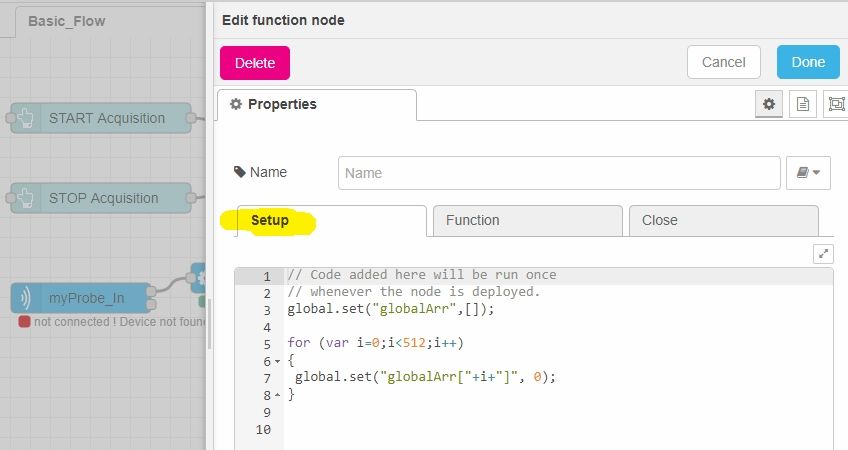

@Georgy Moshkin​ Thanks for this answer. It looks like exactly what I needed.
Unfortunately I have one little problem I cannot solve. The line "global.set("globalArr["+idx+"]", msg.payload.variabledata[0].y);" causes an error "Error: Invalid property expression: unexpected N at position 10". I think this is because I have not defined the global array globalArr. You say "setup tab: creating global variable globalArr". I cant seem to find a place to do this. Can you give more details please?
Georgy Moshkin
Senior
Sep 20, 2021 1:08 AM UTC
Double click on "f | function" rectangle → "Edit function node" window appear with three tabs in it: "Setup" / "Function" / "Close".
By default second tab is opened "Function" with main source code, you need to open "Setup" tab:
Check my STM32 Bootloader - flash your STM32 with AES-encrypted binaries right from web browser!
ADunc.1
Senior
Sep 20, 2021 3:29 AM UTC
Thanks for the prompt feedback. I do not have the setup tab! I downloaded STM32cubeMonitor V1.1.0 today.
Georgy Moshkin
Senior
Sep 20, 2021 3:42 AM UTC
I didn't try new version yet, I'll try it later, hope somebody can comment sooner.
ADunc.1
Senior
Sep 20, 2021 9:08 PM UTC
Thanks. I had fallen into the trap of selecting V1.1.0 from the drop down. I had wondered where you got V1.2.0 from! I should have opened my eyes...
After updating the setup tab is visible and the warning message is gone. Note that even though there was a warning message it was still working correctly and was super helpful in debugging.
Thanks for taking the time to share your idea and help me.
