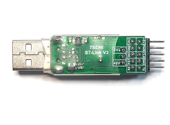

Hi Team,
SPI communication is established between STM32F411RCT6(master) with ADS1298(slave). When i run the code , then notfication came to console:
Error: Operation exceeds memory limits
Error: failed to erase memory
Encountered Error when opening C:\ST\STM32CubeIDE_1.13.1\STM32CubeIDE\plugins\com.st.stm32cube.ide.mcu.externaltools.cubeprogrammer.win32_2.1.0.202305091550\tools\bin\STM32_Programmer_CLI.exe.
Error in STM32CubeProgrammer
Shutting down...
the STM32Cube IDE that iam using is 1.13.1, and with the ST-LINK Utility and STM32CubeProgrammer , i tried to erase the flash memory, iam able to do a mass erase.

Please upload a photo of your ST-LINK.
Regards
/Peter

‎2023-10-17 9:49 PM
Hi Peter
Glad to get in touch. Iam using ST-Link from 7SEMI is a USB-based programmer and in-circuit debugger designed for STM32 microcontrollers.iam herewith attaching the photos of the ST-link . Kindly go through.
Thanks and Regards
Neelima S

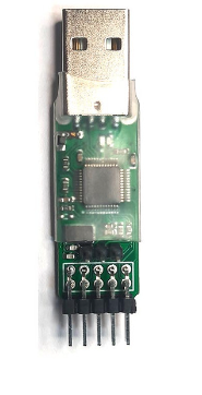

‎2023-10-17 9:53 PM
Sorry for not providing the correct part number its STM32F411RCT6 . Iam using ST-Link from 7SEMI is a USB-based programmer and in-circuit debugger designed for STM32 microcontrollers. I have attached the photo of the debugger iam using. Kindly go through
Thanks and Regards
Neelima S
‎2023-10-18 6:16 AM
The topic has been discussed very often in the community: It is an illegal clone of an ST-LINK with a different MCU, whose behaviour ST does not know and therefore cannot support. Please buy an original ST-LINK, then you won't have such problems.
