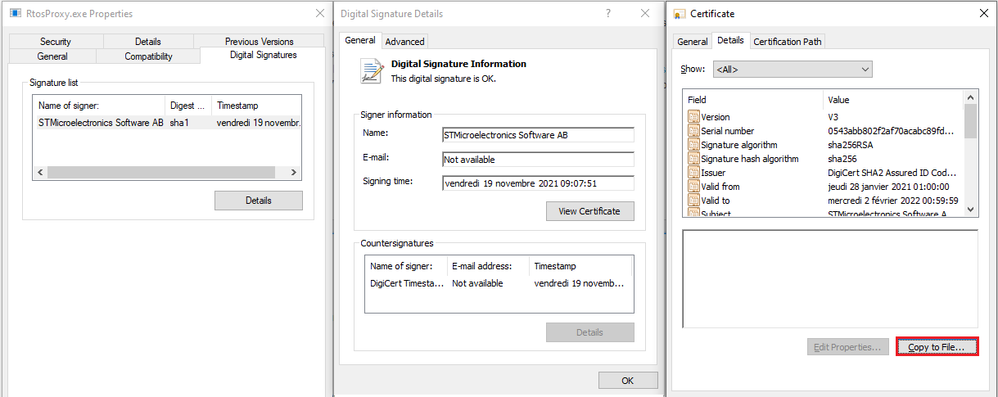

After we installed the STM32 Cube IDE program version 1.8.0 (the installation file is downloaded from STM site), our company Anti Virus software has detected that the program contains virus.
From the report of the Anti Virus program, the file contains virus is "rtosproxy.exe" located in "C:\st\stm32cubeide_1.8.0\stm32cubeide\plugins\com.st.stm32cube.ide.mcu.externaltools.rtosproxy.win32_1.0.100.202109170922\tools\bin\rtosproxy.exe".
It seems that there is no this file when we installed the version 1.7.0 and the Anti Virus software has not reported problem with this version.
So could you tell us what is this file used?
And please confirm that this file is safe and no malicious code.

Hi @HNguy.18​,
If the authenticity of RtosProxy.exe can be verified then you can use it safely, it's not a malware at all.
The authenticity can be ensured by checking the digital signature:

This is a utility executed during the Debug flow to enable some RTOS useful features.
Hope this helps
