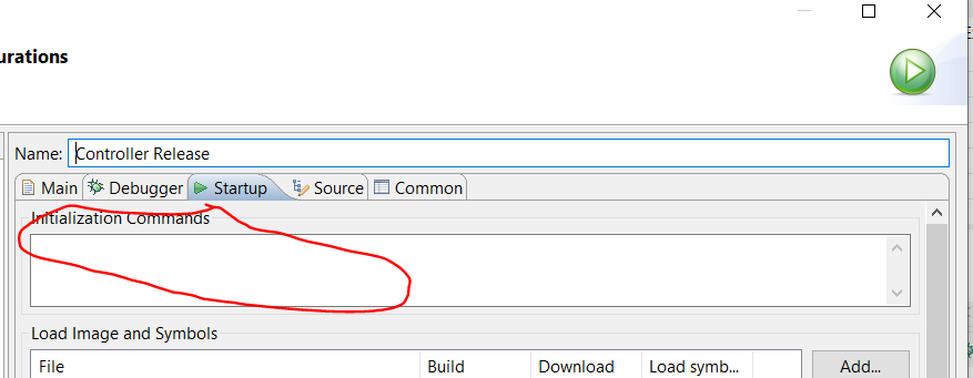

I flash a project for debugging and set some breakpoints. Then I compile for release and run the code using the green arrow symbol. The code is flashed, but does not run, as it is stuck in a breakpoint from earlier debug sessions.
Is there a way to automatically remove all breakpoints in the device when starting a "Run" configuration?

power cycling is what I always need to do now. there should be an easier way, in my hardware this is quite complicated.

thanks, but no, this removes the breakpoints in the IDE. I want to keep the breakpoints in the IDE for debugging, just clear them from the device memory when running a release version. I guess there should be some initialization commands in the run config, but I don't know which commands are available there.

no no. I assume the breakpoints are somehow still in the memory of my stm32. during "run", I don't want them there, only during "debug'. So if I click on run, the breakpoints can still be in the IDE ( I might need them again in next debug session), but they should be removed in the stm32 during run.
I hope that makes it a bit more clear ;)

I never inserted software breakpoints, so how can I make gdb delete all breakpoints when I want to run release?
Have a try to toogle off all your breakpoints relying on "Run > Skip All Breakpoints".
Then launch a debug session on target. Once running stop it.
Have new try in run mode then.
If debug session and no breakpoint active GDB should do proper cleanup.
