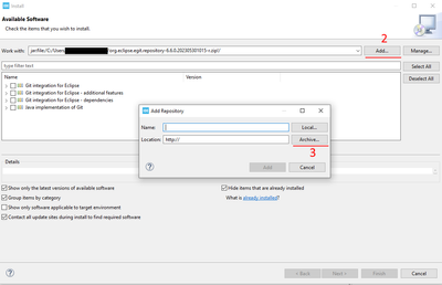

Do anyone know how to install the Egit plugin in an offline machine(Windows)?
Solved! Go to Solution.
2023-06-20 1:43 AM
you can download the latest build of EGit from this web page (or this is the direct link). That is a copy of the update site packaged into a .zip file. You can use that zip file following these steps:
- Select the menu command "Help > Install New Software ..."
- Press Add button
- Press the Archive button
- Point at the zip file, select the features you want to install and follow the screen instructions
