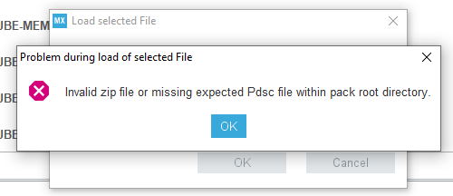

I've been trying to use SMBus, ST seem to have a middleware package. X-Cube-SMBus, however it won't load because there is a .Pdsc file missing. I assume this was created some time ago before Pdsc was required. Can I make one or does someone have one?

Hello MHarr.2,
Feel free to suggest something ! We will look at it.
For your information, mid of this year, we're going to provide a tool helping you designing a pack configurable by CubeMX.
The pdsc will be anyway required as a first step...
Regards,
Laurent

Hi Laurent,
thanks for the update , in the meantime I went to CMSIS site and will try and put something together.
Regards
Mike
