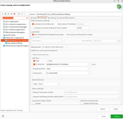

how to to flash stm32mp257-DK in baremetal with cube ide ?
maths
STM32CubeIDE
Version: 2.1.1
Build: 28236_20260312_0043 (UTC)
How can I make sense of this ?
TMicroelectronics ST-LINK GDB server. Version 7.13.0
Copyright (c) 2026, STMicroelectronics. All rights reserved.
Starting server with the following options:
        Persistent Mode            : Disabled
        Logging Level              : 1
        Listen Port Number         : 61234
        Status Refresh Delay       : 15s
        Verbose Mode               : Disabled
        SWD Debug                  : Enabled
Waiting for debugger connection...
Debugger connected
Debugger connected
                        STM32CubeProgrammer v2.22.0
Log output file:   /tmp/STM32CubeProgrammer_Xj0e11.log

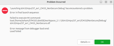

Error: Unable to connect to the target device, Access port is not valid.
Encountered Error when opening /home/soham/st/stm32cubeide_2.1.1/plugins/com.st.stm32cube.ide.mcu.externaltools.cubeprogrammer.linux64_2.2.400.202601091506/tools/bin/STM32_Programmer_CLI
Shutting down...
Exit.
I have added the "monitor flash mass_erase" to starter as explained in this thread,

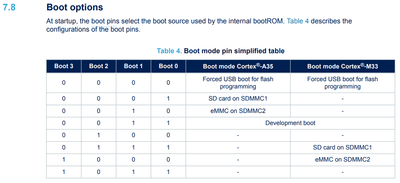

I have set the boot switches into dev mode 0011:
