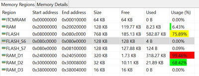

I am using stm32h723/33vgh6 development board. In that i am getting OUT of RAM memory i need to move some of runtime functions in object file to another RAM section from RAM_D1 or merge the RAM partiton into RAM_D1 to overcome from that issue.
is it possible to do merging of ram partitions to overcome the issue. i am attaching memory analyzer photo below
please give some solutions.

The memory regions are often predefined in the hardware and set up in the linker script and configuration files provided by the board's vendor or manufacturer.
There's no way to merge them seamlessly and have the linker handle it automatically. You can assign individual variables to other regions manually.
is there is no possibility of merging the RAM sections manually? inbetween there is reserved memory is present. if yes please give some solutions otherwise any alternative options todo that issue solved?

Right, not using STM32CubeIDE.
