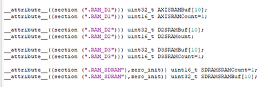

I want to define global variables with initial values in different RAM regions (e.g., RAM_D1, RAM_D2) using STM32CubeIDE for STM32H743.

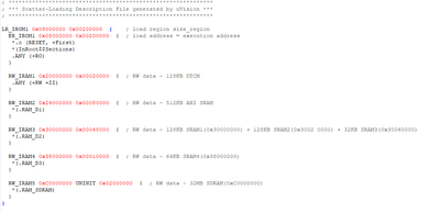

In Keil, I can usually achieve this by modifying the SCT file as shown in the diagram below.
However, simply adding a section in the LD file does not ensure that variables will have initial values.
So how can I, like in Keil, achieve the definition of global variables with initial values in different RAM regions of STM32H743 using a simple method such as __attribute__ in the code or any other straightforward approach?

Thank you for your response. I believe I have found a solution. I have defined RW-data in the RAM_D1 region using the following method.
1:Add the RAM_D1 section in the LD file.
 /* used by the startup to initialize data */
 _siram_d1_data = LOADADDR(.ram_d1_data);
 /* Initialized data sections goes into RAM, load LMA copy after code */
 .ram_d1_data :
 . = ALIGN(4);
 _sram_d1 = .; /* create a global symbol at ram_d1 start */
 *(.ram_d1_data)
 *(.ram_d1_data*)
 . = ALIGN(4);
 _eram_d1 = .; /* create a global symbol at ram_d1 end */
 } >RAM_D1 AT> FLASH
 2:Add the following assembly code in the startup file.
 ldr r0, =_sram_d1
 ldr r1, =_eram_d1
 ldr r2, =_siram_d1_data
 movs r3, #0
 b LoopCopyRAMD1DataInit
CopyRAMD1DataInit:
 ldr r4, [r2, r3]
 str r4, [r0, r3]
 adds r3, r3, #4
LoopCopyRAMD1DataInit:
 adds r4, r0, r3
 cmp r4, r1
 bcc CopyRAMD1DataInit
