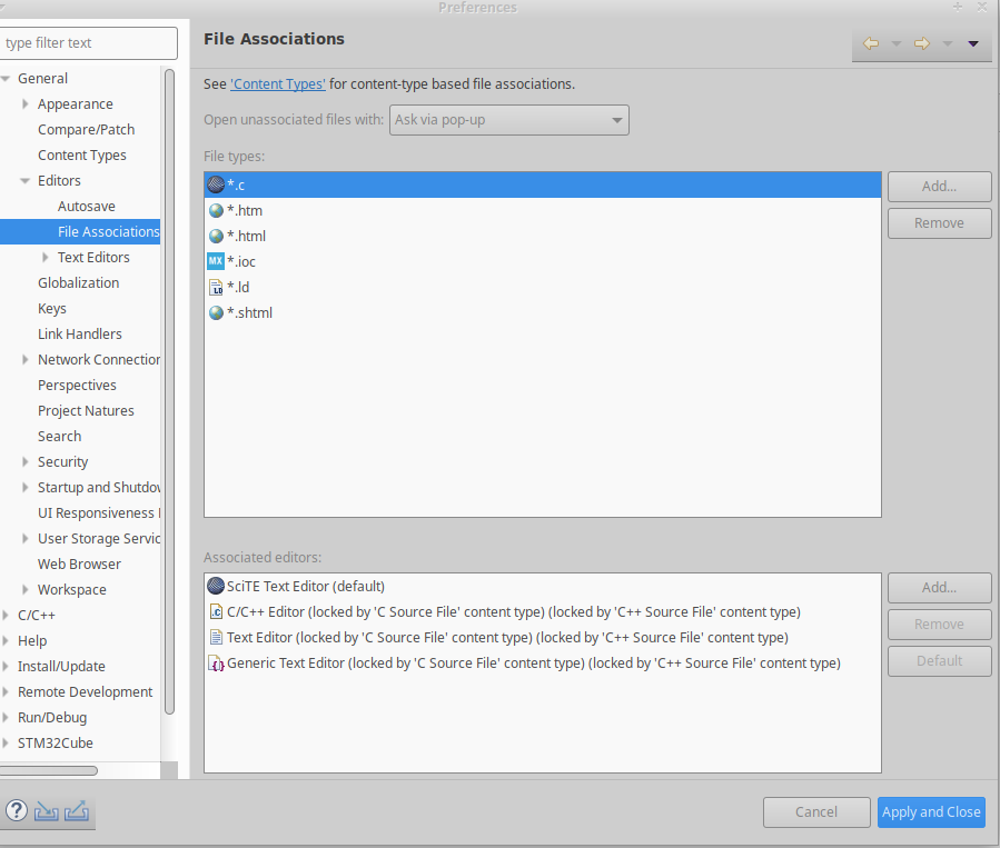

Dear experts,
I have started with STM32CubeIDE (tried 1.0.0 and 1.0.1) on Xubuntu Linux. After generating code and trying to open main.c I'm getting error messages telling me that no more handles were available and there were "SWT errors". The IDE suggests these were non-recoverable errors and I should exit and restart the IDE (no other options, anyway). Following this recommendation, I'm immediately caught in the same endless loop, unable to access my work.
While after some googling, I conclude that this is an Eclipse related editor problem, I suppose that preventing the IDE to automatically open any file with the internal editor might do the trick that I could at least complete the MCU configuration and then take my code to a different IDE (MSVSC with Platformio Plugin intended), other than restarting from scratch and avoiding to open any file within the IDE.
Any clues where the list of files to be opened is stored (or how to fix the underlying Eclipse related problem)? Is there a way to specify an external editor?

File association can be accessed through [Windows -> Preferences -> STM32Cube -> File Association] as well as [Windows -> Preferences -> General -> Editors -> File Associations].

Not a solution, but a workaround (as it does not provide recovery of existing data, it only prevents the problem to occur in a new project):
The SWT Error Issue indeed seems to be associated with the internal editor of Eclipse, as defining a file type *.c and associating it with an external editor (e.g. Scite) seems to help. One has to do it before a generated file is opened.
