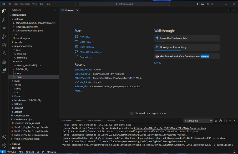

When I load STM32CubeIDE .cproject in VSCode the only source files that are shown are files in Core/syscalls.c, Core/sysmem.c and Startup/startup_stm32wl55jcix.s
The project builds successfully when imported and I can even start debug but I can not see main.c. If I load the same project in STM32CubeIDE all the files show correctly.
I have tried re-installing Visual Code and STM32 VS CODE EXTENSION
Any idea on what is happening.
ola
To add some more information to the above bug report. This bug is only visible when I use the example project from the Example Selector option that STM32CubeMX presents. The example project that I was trying to load was the SubGHz_Phy_Per project.
However if I start using the Board Selector option then the project created load correctly in VS code.
