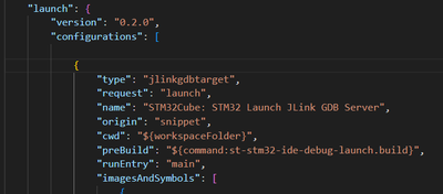

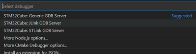

I have setup STM32 VScode extension in my PC, which is awesome. But I found I can not use a Jlink or daplink to flash or debug my board, only STlink is supported. How can I debug with other debuggers in VScode?
Any help will be appreciated.
vincent_grenet
JLink is supported.
Mastering fully your elected probe you can play with so called generic one. More DIY but possible.
