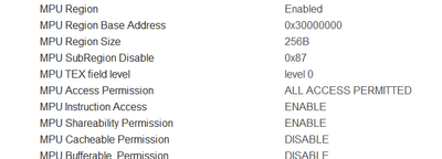

Hi Pavel,
Yes you are correct, .bss and .data are also placed at 0x2400000 (see below) but for my simple test case just changing _estack was sufficient.

The final solution2 (which is what I am going to use) is to use MMU to create a small memory hole for the DMA buffers in RAM_D2 with the dcache is disabled. This is easy to do using STMCubeMX and also worked.
The only change I had to make was to initialize the DMA buffer as there is no default initialization (as mentioned in the article),
