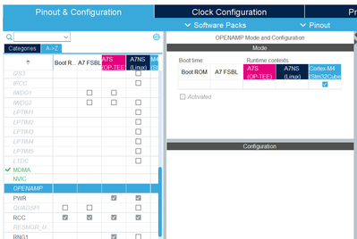

When I add OpenAMP to Pinout & Configration of .ioc and build it, the build fails
The steps are as follows:
  • Create a new project (fuga_oka) for STM32MP277F-EV1 in STM32CubeIDE
  • Build this project. The build will finish successfully
  • Add OpenAMP to this project
  • Open fuga_oka.ioc
         - Select OPENAMP in Pinout & Configration -> middle ware & Software Packs
         - Check M33NS(Cube)
         - Also check Activated
         - Save fuga_oka.ioc
Build the project. Some errors will be reported and the build will fail

I thought the error was due to a lack of include path settings, so I tried to add an include path, but I couldn't find the metal folder in the project and couldn't set it.
Is there a problem with the project creation or build procedure?
