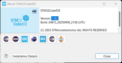

How can I activate CSI i STM32CubeIDE for STM32MP257?
DMårt
Lead

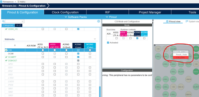

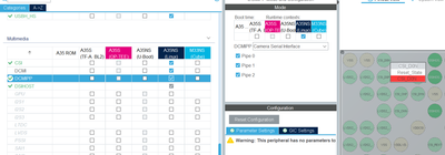

As you can see, I'm missing something.
Any special clock I need to activate?
I have activated CSI from DCMIPP. But still the CSI cannot get its pinns green.

Hello @DMårt
From what I can tell, this is the same problem that was reported for STM32N6 in this post. Our team is aware of this issue, and it is currently under review (Ticket 222040 This is an internal tracking number and is not accessible or usable by customers).)
BR, Souhaib

@Souhaib MAZHOUD
Now I have tried with latest CubeMX 2.0.0.
Still the same. Is there any walk around for this? Like manually open the .ioc and enabling the CSI?
