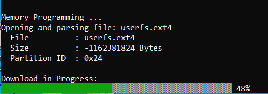

Hi everyone,
I have a problem using STM32CubeProgrammer (and CLI). They are both showing that my userfs partition have a size of -1162381824 bytes. That partition have size of 2.9GB. After programming with CubeProgrammer I have kernel panic, and I don't know if this is related to CubeProgrammer. I'm trying to program SD card partition by partition using STM32CubeProgrammer but I don't have luck. When I get whole RAW image of SD card and then flash another SD card everything is working. When I get bootfs, userfs, vendorfs and rootfs using dd comand from SD card and then try to program using CubeProgrammer, kernel panic happens. Where I am wrong?

I'm using this this tsv:
#Opt Id Name Type IP Offset Binary
- 0x01 fsbl1-boot Binary none 0x0 arm-trusted-firmware/tf-a-stm32mp157c-osd32mp1-brk-serialboot.stm32
- 0x03 ssbl-boot Binary none 0x0 bootloader/u-boot-stm32mp157c-osd32mp1-brk-trusted.stm32
P 0x04 fsbl1 Binary mmc0 0x00004400 arm-trusted-firmware/tf-a-stm32mp157c-osd32mp1-brk-trusted.stm32
P 0x05 fsbl2 Binary mmc0 0x00044400 arm-trusted-firmware/tf-a-stm32mp157c-osd32mp1-brk-trusted.stm32
PD 0x06 ssbl Binary mmc0 0x00084400 bootloader/u-boot-stm32mp157c-osd32mp1-brk-trusted.stm32
P 0x21 boot System mmc0 0x00284400 boot.ext4
P 0x22 vendorfs FileSystem mmc0 0x04284400 vendorfs.ext4
P 0x23 rootfs FileSystem mmc0 0x05284400 rootfs.ext4
P 0x24 userfs FileSystem mmc0 0x33C84400 userfs.ext4
Ext4 partitions are backed up from working SD card using dd (sudo dd if=/dev/sdbX of=<name.ext4>). Trusted firmware and U-Boot is same as working SD card (they are built on virtual machine). I used gdisk on MP1 with working system to compare the partition offsets, and I multiplied starting sector with sector size of 512Bytes and convert that to hexadecimal number and offset is exactly the same as in .tsv file.

‎2021-02-23 2:40 AM
Hi @NGajic​ ,
>> I made one FAT32 storage for USB mass storage (64MB) on userfs
Probably the issue. So far our boot device only support GPT/EXT4 formating.
See https://wiki.st.com/stm32mpu/wiki/STM32MP15_Flash_mapping
Olivier
‎2021-02-23 4:02 AM
Latest news,
I removed file that represented 64MB of FAT32 and then I do the backing up of all partitions with dd. Then used STM32CubeProgrammer_CLI and flashed everything. Again it showed negative size in bytes for userfs partition but now kernel boots, there's no kernel panic. Conclusion is that I have to flash and then I can make FAT32 mass storage file.
