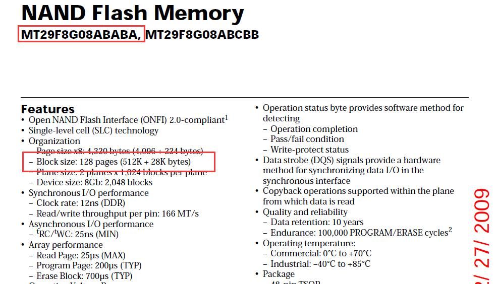

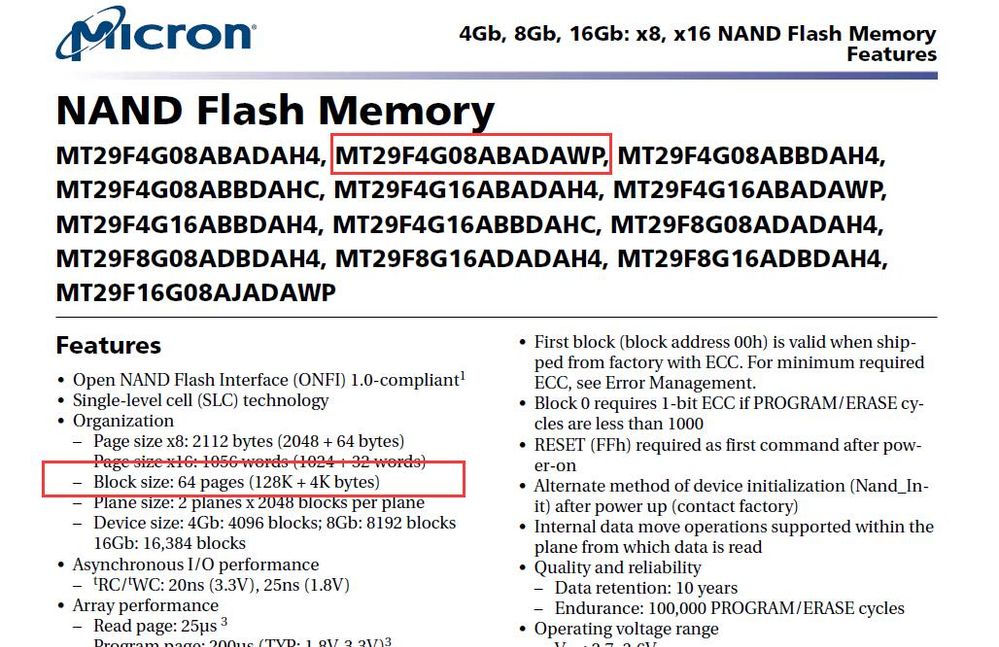

Thank you for your quick reply, the following pictures are datasheets of the two NAND, please check them.
Sorry, the full name is MT29F8G08ABABAWP-ITC , and it's block size is 512KB,
The full name of MT29F4G08 is MT29F4G08ABADAWP-ITD , and it's block size is 128KB.
