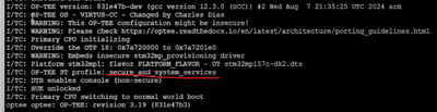

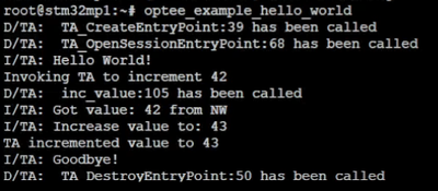

Charles Dias
August 8, 2024
Hello @Erwan SZYMANSKI,
The last link shared by you help me a lot! Thank you!
I was stuck on how to create the FIP with the updated TF-A and OP-TEE at the same time. When I ran the commands described at the beginning of this post, the FIP was generated with only the TF-A or OP-TEE update information, not both. Using the fiptool I updated the fip file.
Profile changed to secure_and_system_services.
Test with optee_example_hello_world.
