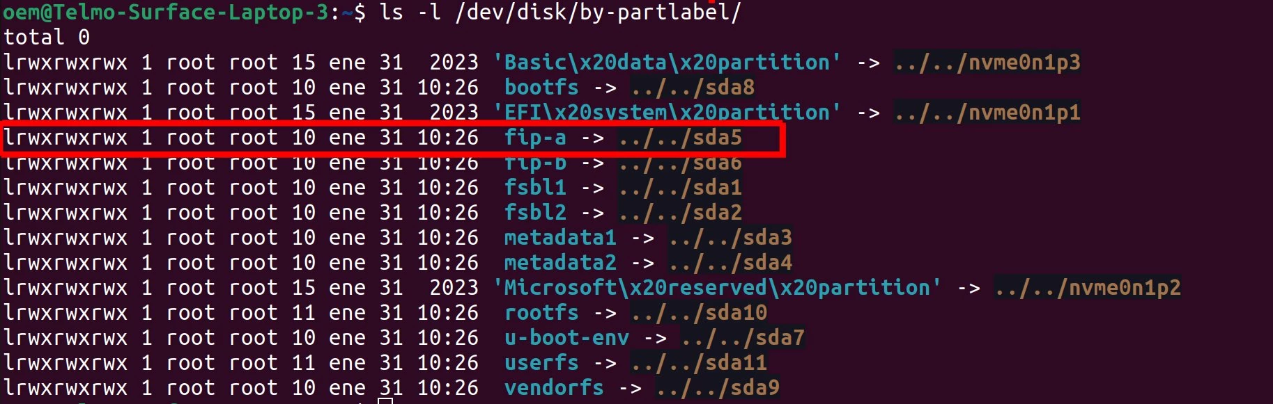

JIrao.1
JIrao.1Author
January 31, 2023
Hi @Erwan SZYMANSKI​ thanks for your reply! :beaming_face_with_smiling_eyes:
I have read and followed the steps of the wiki page (how to cross compile with the distribution package):
  • I have created fip-stm32mp157c-core_communication_new-mx-trusted.bin file with the above settings.
  • I then copied the binary to the sda5 dedicated partition:
  • Finally, I have rebooted the board but the M4 firmware does not boot.
I do not know if the ${kernel_addr_r} is not correctly asigned or I have forgotten some step.
Can you help me?
Thanks!
