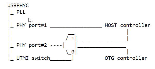

The other point is about the "phys" configuration of your usbotg_hs config:
In your DTB/DTS, we can see:
phys = <0x2d 0x00>;
phy-names = "usb2-phy";
which means:
phys = <&usbphyc_port1 0>;
If you want to use the usboth_hs in host mode, you have to set the phys port like this:
phys = <&usbphyc_port1 1>;
The second parameter indicates if you want to use the OTG controller or the Host controller. This is explained here with a great ascii-art :
https://elixir.bootlin.com/linux/v5.12-rc2/source/Documentation/devicetree/bindings/phy/phy-stm32-usbphyc.yaml
So if extra parameter of &usbphyc_port1 is 0, OTG controller uses DP2/DM2, if it is 1, HOST (USBH) controller uses DP2/DM2.
Since you want to configure the "usbotg_hs" node as a host, you must put 1 in extra parameter of &usbphyc_port1.
And regarding the phys port that you used for usbh-ehci and ohci, I don't think you must use the port0:
phys = <&usbphyc_port0>;
phy-names = "usb";
Because if you look at the wiki page:
https://wiki.st.com/stm32mpu/wiki/USBH_device_tree_configuration#DT_configuration_when_using_the_two_physical_ports
You can see that to configure the UTMI switch (like for the OTG) in USB Host controller, you have to use the port #2:
/* Use USBPHYC HS PHY port #2, configure UTMI switch to select USBH controller */
<&usbphyc_port1 1>;
