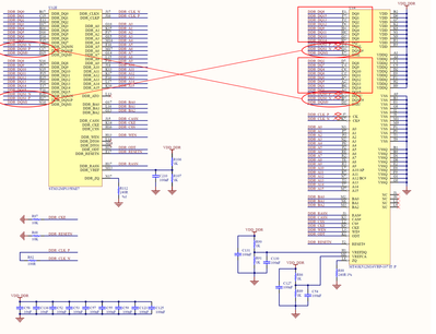

Thank you for your response.
I have some questions regarding the "STM32MP13x Series DDR memory routing guidelines examples" you mentioned in your previous response. I apologize for not reviewing the materials more carefully.
Could you please explain why the Data Bit (DQ Pin) connections of the DDR (MT41K512M16VRP) need to be connected as shown in the example rather than in a 1:1 manner (e.g., DDR DQ0 to DQ0)? Is there a specific reason for this?
 Like
   DDR DQ8   ↔ DQ0
   DDR DQ15 ↔ DQ1
   DDR DQ13   ↔ DQ2
   DDR DQ12 ↔ DQ3
   DDR DQ9   ↔ DQ4
   DDR DQ11 ↔ DQ5
Additionally, why are the DQS0 and DQM0 of the STM32MP13 located next to the DQ07 pins, while the DQS0 and DQM0 of the DDR are positioned next to the DQ815 pins? Should the DQS0/1 and DQM0/1 of the STM32MP135FAE7 and the DDR be connected in a crossed manner?

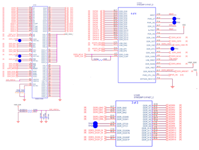

Furthermore, we have attached our DDR connection schematic for your reference.
Thank you very much for your assistance.
Hi @Stnoobs
on DDR memories, you have some freedom to swap bit within a byte and swapping bytes. This is to ease PCB routing to achieve better signal integrity (e.g. avoid some vias).
This is described in various documents linked above.
On our board example, we do both. This explain why you see DQS0/DQM0 together with DQ0-7, which is the lower byte of STM32MP13 connected the the DDR3L upper byte.
As general, a memory does not care about bit or byte number, you simply read a bit value where you have written it. There is some exceptions when there is 'registers' using DQ inside the memory (e.g. LPDDRx)
As spotted in my first reply, your schematics confirm there is a mistake around DQM/DQS. Your DM0/1 are swapped (i.e. if DQ0-7 and DQS0 are connected to lower byte of the DDR, then DQM0 must be also going to lower byte).
This explain your issue around byte write (as the byte 'mask' does not mask the right byte on the memory bus).
There is no solution than reworking your PCB.
Regards.

Thank you.
After modifying the circuit according to your advice and checking it again, the values are written correctly now.
