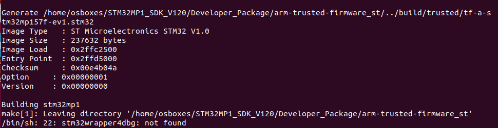

I executed the following command in linux system:
make -f Makefile.sdk all TF_A_CONFIG=trusted FTA_DEVICETREE=stm32mp15c-ev1
but there is the following fault information:
/bin/sh: 22: stm32wrapper4dbg: not found
I have a try to install it, this is not successful. (sudo spt-get install stm32wrapper4dbg)
How to fix this question?

Hello DXian (Community Member)
Using the latest available image (openSTLinux 2.0.0), no issues on my side.
Have you correctly installed the SDK and sourced the SDK env?
stm32wrapper4dbg is found here <STM32MPU-Release-20-06-24>/Developer-Package/SDK/sysroots/x86_64-ostl_sdk-linux/usr/bin/stm32wrapper4dbg

DXian
Thanks for your reply. I will re-install all software.
