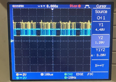

I am using a STM32MP157C development board from Myirtech and trying to interface the board with a CAN device.
I am able to bring up the can0 interface. It can send data, I can see it from oscilloscope over Can Hi and Lo pins. The dmesg output is below:

But when the device on the can bus sends data, the board does not receive anything. (I am checking by using candump can0)
Any help would be appreciated.

The remote device is a BMS. Both sides have bus termination resistors of 120 ohms. The baud rate is 500Kbps.
The device sends data continuously. As I suspect, the remote side (STM32MP1) is not sending ACK signal.
The screen above shows Can Hi and Lo signals.

The problem is solved, it was a baud issue.
