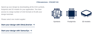

As we are developing the camera streaming board for one of our client, I have the following queries:
  1. Both part numbers, STM32MP135DAG7 and STM32MP135FAG7 come in the TFBGA289 (9×9) package. Are the pinouts identical for both devices? can we interchange the part in PCB assembly?I believe only security features are add in F
  2. Please share the OrCAD schematic library files for both MPUs — STM32MP135DAG7 and STM32MP135FAG7.

Hi @Venkat_07 ,
I confirm @jameswilliam statements.
You could generate symbol and footprint of STM32MP135Dxx for your favorite CAD format from this link:
https://www.st.com/en/microcontrollers-microprocessors/stm32mp135d.html#cad-resources
