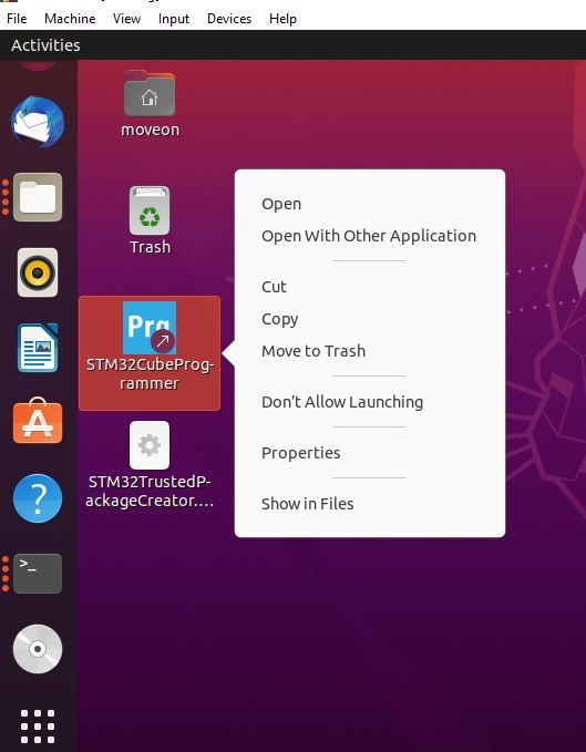

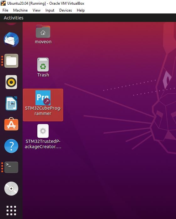

it is working properly. But i am facing problem on Launching STM32Cubeprogrammer in Ubuntu 20.04 version.
i downloaded all firmware's but i am able to open . please check the below attachment.0693W000005COD3QAO.jpg images.0693W000005COCjQAO.jpg
