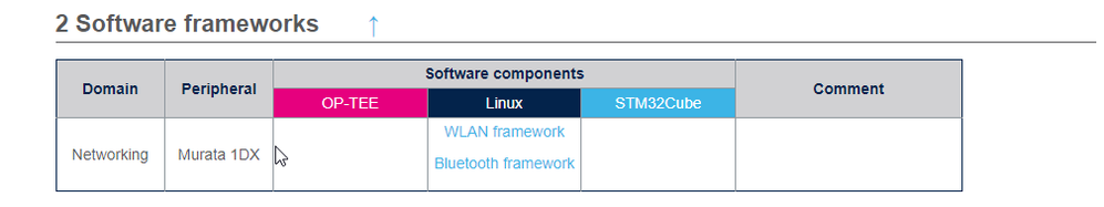

On the STM32MP157C-DK2, can I use/interface the available muRata 1Dx with core-M4 only (& not core-A7)? I am not quite sure if the wifi module 1dx (U8 on the kit) is controlled by A7 or M4?
Anyways, I want to interface it with M4. So, can it be possible?

The software framework needed to make the murata 1DX works is only available under linux (A7Core).
As specified on the wiki related to WLAN: https://wiki.st.com/stm32mpu/wiki/WLAN_and_Bluetooth_hardware_component#Software_frameworks
Regarding the hardware assignment of the peripheral and its DT configuration, you can see in the following link, that the brcm node is defined in the node sdmmc2:
https://wiki.st.com/stm32mpu/wiki/WLAN_device_tree_configuration#DT_configuration_-28board_level-29
It is explained in the Peripherals overview page that sdmmc2 is CortexA7 only:
https://wiki.st.com/stm32mpu/wiki/STM32MP15_peripherals_overview#Internal_peripherals_overview
So you can't use the module muRata 1Dx with core-M4 only.
