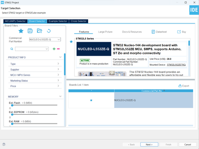

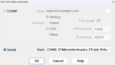

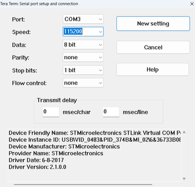

Issue with terminal output at putty with simple Helloworld program using Nucleo-L522ZE-Q.
raitaimoorali

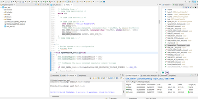

  while (1)
    /* USER CODE END WHILE */
    /* USER CODE BEGIN 3 */
	  char buffer[]="Hello World\r";
	  HAL_Delay(100);
	  HAL_UART_Transmit(&huart2, (unsigned char *)&buffer, 6, sizeof(buffer));
	  HAL_Delay(1000);
	  HAL_GPIO_TogglePin (GPIOC, GPIO_PIN_7);
  /* USER CODE END 3 */

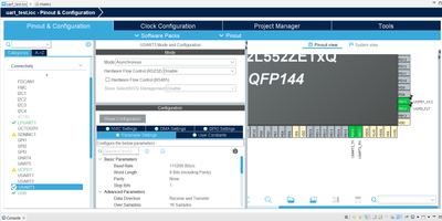

  huart2.Instance = USART2;
  huart2.Init.BaudRate = 115200;
  huart2.Init.WordLength = UART_WORDLENGTH_8B;
  huart2.Init.StopBits = UART_STOPBITS_1;
  huart2.Init.Parity = UART_PARITY_NONE;
  huart2.Init.Mode = UART_MODE_TX_RX;
  huart2.Init.HwFlowCtl = UART_HWCONTROL_NONE;
  huart2.Init.OverSampling = UART_OVERSAMPLING_16;
  huart2.Init.OneBitSampling = UART_ONE_BIT_SAMPLE_DISABLE;
  huart2.Init.ClockPrescaler = UART_PRESCALER_DIV1;
  huart2.AdvancedInit.AdvFeatureInit = UART_ADVFEATURE_NO_INIT;
  if (HAL_UART_Init(&huart2) != HAL_OK)
    Error_Handler();
  if (HAL_UARTEx_SetTxFifoThreshold(&huart2, UART_TXFIFO_THRESHOLD_1_8) != HAL_OK)
    Error_Handler();
  if (HAL_UARTEx_SetRxFifoThreshold(&huart2, UART_RXFIFO_THRESHOLD_1_8) != HAL_OK)
    Error_Handler();
  if (HAL_UARTEx_DisableFifoMode(&huart2) != HAL_OK)
    Error_Handler();

What pins are you using? How are those pins connected to the PC? Can you open the port? What port are you opening? Do your port setting match?
Note that the VCP is on USART3, not USART2.
TeraTerm could also be buffering until it sees a "\n", but less likely.

Parameters here are all wrong.
Try this
HAL_UART_Transmit(&huart2, (unsigned char *)buffer, strlen(buffer), 500);

I have also tried to print hello world using USART3 but could not get at putty teraterm. I have attached the SS of all steps i have done please check. thanks
Hello @Tesla DeLorean
Thanks for the reply i also tried your solution, but it did not work.
for usart2
PA2 = USART2_TX
PA3 = USART2_RX
for usart3
PB10 = USART3_TX
PB11 = USART3_RX
but it did not work
Hi @Issamos
Thanks for the reply. I I tried with USART3 but things do not work. I have uploaded the steps please check including teraterm settings.
>>but it did not work
How is USART2 supposed to be working in this context? How's it wired up that would facilitate this?
Isn't the ST-LINK VCP connected via LPUART1 on PG7 and PG8 on the NUCLEO-L552ZE-Q ??
