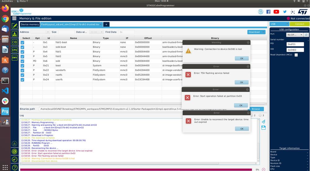

Hello everyone!
I'm getting familiar with the STM32MP1 tools on a linux laptop and I'm trying to burn the demo to my STM32MP1D-DK1 board. I know most the demos are aimed at the DK2 but it's sold out everywhere and I don't currently need wifi or bluetooth (or an LCD), so this seemed good enough for me.
Anyway, I'm trying to follow the instructions on the STM32MP1 wiki page (
https://wiki.st.com/stm32mpu/wiki/Getting_started/STM32MP1_boards/STM32MP157x-DK2/Let%27s_start/Populate_the_target_and_boot_the_image) and I'm running into an issue when trying to burn the firmware:
0693W000008yDwZQAU.jpgUnfortunately, I get the errors above, a red LED (LD5?) starts flashing on and off, a blue LED (LD6?) stays on, and LD4 continues to toggle on and off about every second or so (this was the same prior to burning the firmware as well.
I tried to follow a similar tutorial to burn via a command line (https://wiki.st.com/stm32mpu/wiki/STM32MP15_Discovery_kits_-_Starter_Package#Preparing_the_USB_serial_link_for_flashing) and had a similar issue. Here's what I'm getting:
~/STM32MPU_workspace/STM32MP15-Ecosystem-v2.1.0/Starter-Package/stm32mp1-openstlinux-5-4-dunfell-mp1-20-11-12/images/stm32mp1$ STM32_Programmer_CLI -c port=usb1 -w flashlayout_st-image-weston/trusted/FlashLayout_sdcard_stm32mp157d-dk1-trusted.tsv

Error:
Unable to reconnect the target device: time out expired
Error: Start operation failed at partition 0x03
The errors look similar, which makes sense (whatever is an issue with one is likely the issue with another).
A few notes, I do have both boot switches turned to off for burning FW, my power supply is rated at 3A, I have the ST-Link USB cable connected, as well as the power supply (5V 3A), and the USB C (USB OTG, just going into a port on my laptop, not a powered hub).
Any idea what might be causing the issue? Is it possible there's an issue with the DK1 files or am I doing something wrong?
Any help you can give me would be appreciated. Thanks!

PatrickF
please have a look to https://community.st.com/s/article/FAQ-STM32MP1-STM32CubeProgrammer-USB-reconnect-error-at-STM32MP1-boot-device-flashing
As you did not rebuilt the binaries, I think it is a Virtual Machine USB setting issue.
Regards.

I apologize for the delay, I got pulled away on another project! Finally getting a chance to circle back!
Thank you so much for that link, it definitely sounds like that is my issue. I was going through the guide and got stuck at the following location:

First, could you try using command line to flash and add "-tm 10000" on the command (increase default timeout to 10 seconds) ?
I agree the FAQ is not crystal clear.
You need to stop load sequence at uBoot console, by enabling only the two first items in CubeProgrammer.
Then, using the serial console (Virtual Com Port of the ST-Link, 115200,n,8,1, see 'The serial terminal'), with CTRL+C you should get the uBoot "STM32MP>" prompt.
Then you could try the requested commands which should make an USB device visible on your PC (this is just for checking purposes).
If not visible, it is a PC setup issue.
Note that the 'DFU in HS Mode' you see is normal and it is the first USB connection from BootROM used to load TF-A and uBoot in RAM.
Then uBoot start and reconnect using a different USB connection 'USB download gadget' (this occur in the log after "Reconnecting the device ..." which is failing on your PC).
  Partition ID  : 0x01
Download in Progress:
[==================================================] 100%
File download complete
Time elapsed during download operation: 00:00:00.569
RUNNING Program ...
  PartID:      :0x01
Start operation done successfully at partition 0x01
Flashlayout Programming ...
Running Flashlayout Partition ...
Flashlayout partition started successfully
Memory Programming ...
Opening and parsing file: u-boot-stm32mp157d-dk1-trusted.stm32
  File          : u-boot-stm32mp157d-dk1-trusted.stm32
  Partition ID  : 0x03
Time elapsed during download operation: 00:00:00.935
RUNNING Program ...
  PartID:      :0x03
Error:
Error: TSV flashing service failed
There is now a solid blue LED on the board (LD8) and LD6 (I think) is a blinking red light.
It appears that I'm back in the same position I was earlier. Not sure if I missed a step or misunderstood something? What am I missing?
Thanks for your help, Patrick!
Hi @JayDev​
There can be two issues here :
  1. The path from which you are taking the flash image layout file sometimes assumes the absolute file paths from current directory and hence fails. You can try taking it out from there and paste in the root of folder path which you give in binaries path.
  2. When we build the image , it creates images with symbolic links to file which have different name. If those symbolic links do not work then you might end up getting above error.
