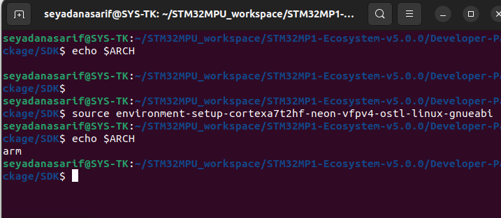

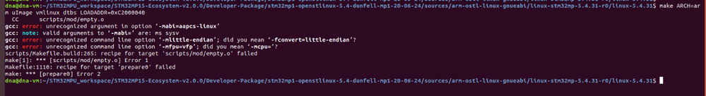

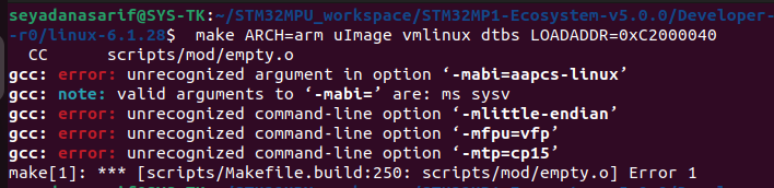

Seyad_Anas_Arif
@ArmandG  i am also facing the same issue while  Build the Linux® kernel source code for the first time. how to rectify this. but i receive correct reply from sdk while i "echo $ARCH" run this commend.
main errormain error
