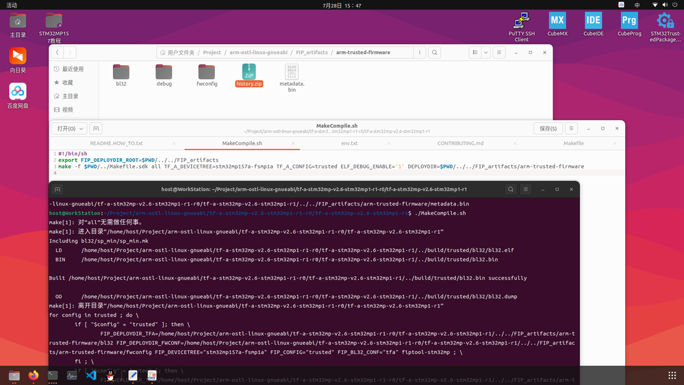

I cannot get "*.stm32" file after compiling tf-a
Options
‎2022-07-28 1:03 AM
I use ubuntu22.04 and stm32mp1-openstlinux-5.15-yocto-kirkstone-mp1-v22.06.15. When compiling TF-A, I can't get STM32 files. Here are the details

Hi xTian.1 (Community Member)
Please follow the README.HOW_TO.txt guidelines in the tf-a developer package directory to make sure all your environment variables are correctly set.
Regards,
Olivier
Options
‎2022-09-21 6:25 AM
Are you sorted out? It is important also to align the OSTL Developper package to the Yocto SDK.
